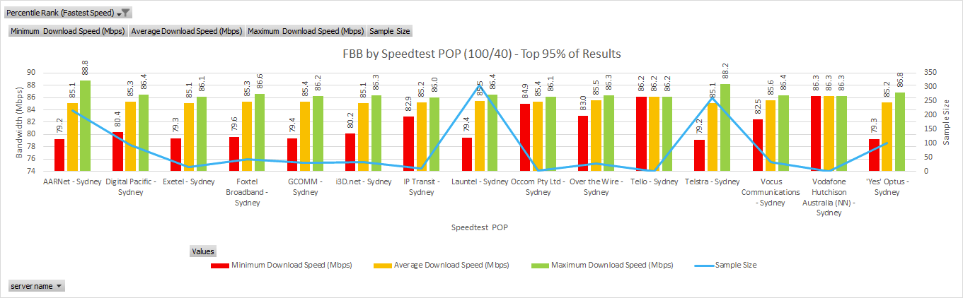

I didn't have the time or the inclination to pull apart my network, particularly while my wife and I work from home on weekdays, to troubleshoot something that is, in my eyes, clearly an upstream issue (likely TPG). My connection seemed to fall foul of the ~85Mbps speed throttling/capping issue (with the occasional flex up to 90Mbps). Outside of a speed test, this was also apparent when downloading games via Steam (rarely would I see speeds above 10MBps (that's megabytes per second, so 80Mbps).
There have been theories about the cause of this throttling/shaping of traffic but we're none the wiser as to the actual cause.

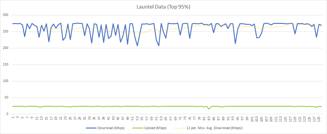

Anyway, I've attached half-hour results for both FBB and Launtel - all of these results were collated using the Speedtest command-line interface tool on a Windows VM with identical network settings within the VM. I let Speedtest CLI choose the best Speedtest POP rather than forcing a specific to remove any personal bias (although I know Telstra in Sydney almost always yielded the best results). Unsurprisingly, the Speedtest results after churning to Launtel have usually selected the Launtel Sydney POP as the preferred server.
Also, to be fair to FBB, I filtered out the worst 5% of results based on download speeds and treated them as outliers.

It's as clear as day something is going on here with averages by Speedtest POP ranging between 85.1 to 85.6Mbps. There are some max values that are in the 88Mbps range (Telstra and AARNet) but everyone else mad max speed results in the 86Mbps band.

Please note, I haven't found a "typical evening" download speed for Launtel's 250/25 service so the target line is missing from the first graph. That said, the dotted yellow line representing the six-hour rolling average (12 data points taken at each half-hour) has, for the most part, remained above 250Mbps. Over-provisioning is well and truly in play as well, with the fastest observed result being just shy of 276.1Mbps (unsurprisingly on the Launtel Sydney Speedtest POP).

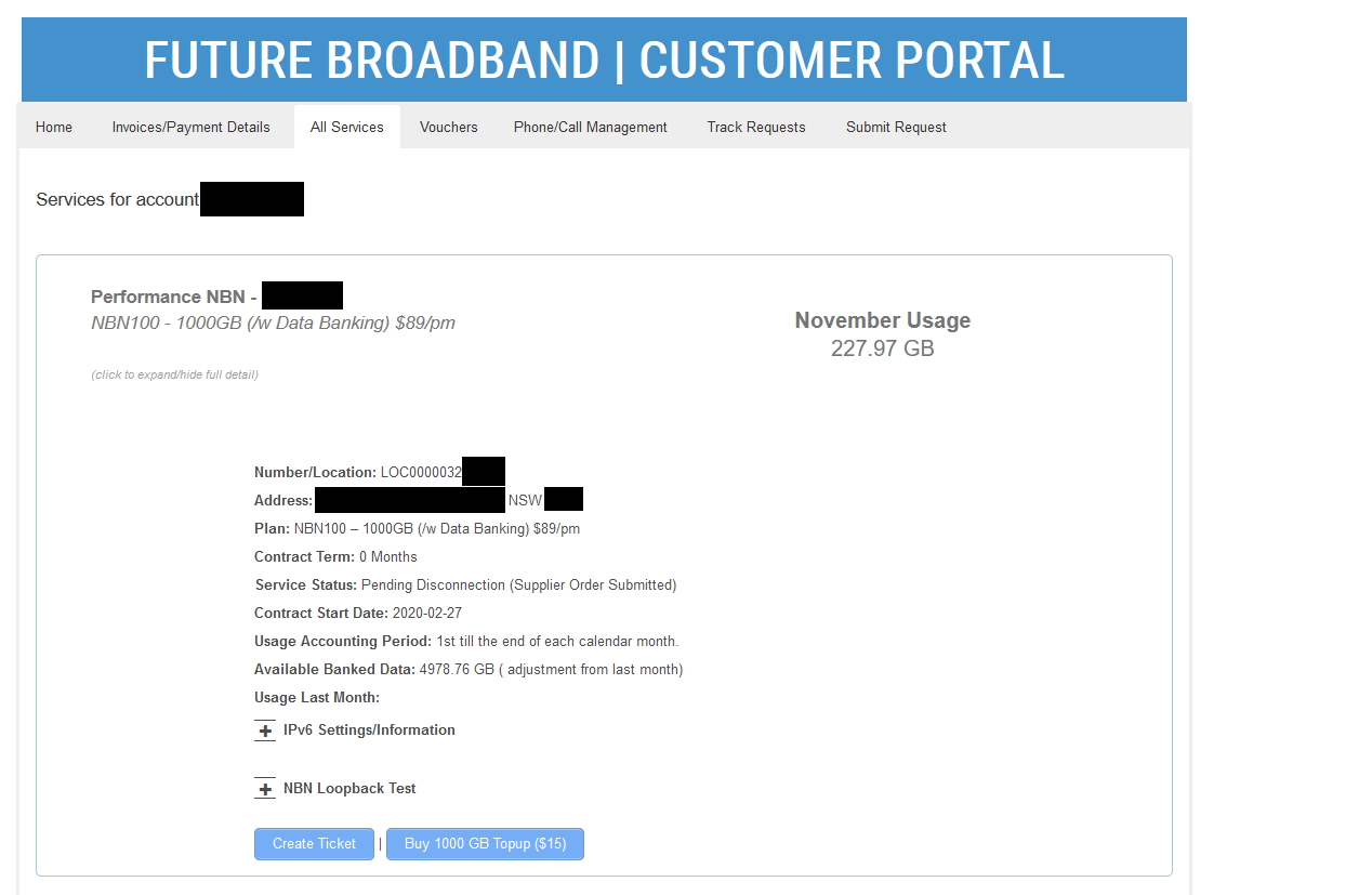

Also, as an addendum, I've noted the following usage on my FBB for the month of November:
FBB Usage Meter.png (41.98 KiB) Viewed 33889 times
The thing is, our internet service churned to Launtel on October 31st. So, where did all of this extra usage come from if we had switched providers? Surely, if this is late arriving usage from October then it should be attributed to October.
