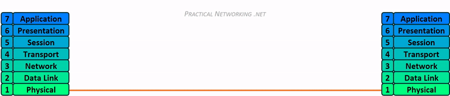

OSI Layers explanation attempt:
Layer 2 uses MAC addresses and is responsible for frame delivery from hop to hop.
Layer 3 uses IP addresses and is responsible for packet delivery from end to end.
Layer 4 accomplishes this by using an addressing scheme known as Port Numbers.
Specifically, two methods of distinguishing network streams exist. They are known as the Transmission Control Protocol (TCP), or the User Datagram Protocol (UDP).
